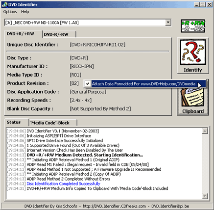

    How to get the Media Code using DVDIdentifier 3.1+
    Download DVDIdentifier v 3.1+ and extract it anywhere.
    Start DVDIdentifier and insert the media in your DVD writer (if it complains about ASPI when you start it or it does not work install the latest ASPI and reboot):
    1. Click on the "Identify"-button.
    2. Right-click on the "Clipboard"-button and select "Attach Data Formatted For www.DVDrHelp.com/DVDmedia".
    3. Left-click on the "Clipboard"-button and then paste the data temporarily somewhere, for example in the text area below.

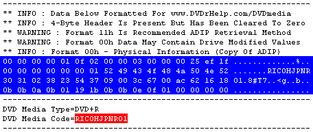

    4. The Media code is the (usually) 11-12 characters in the last line (marked in red in the example below).
    5. The Complete media code is the 3-4 lines of hex data (marked in blue in the example below).
    Example of output from DVDIdentifier:
