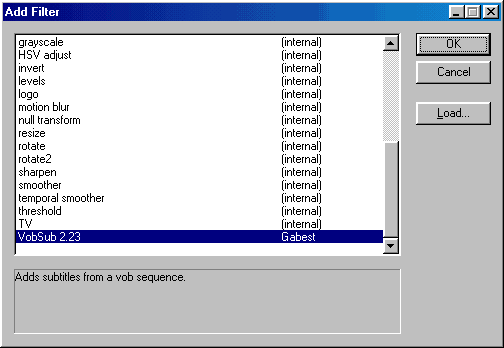

Step 1e) - In the Filters menu, click on the "Add..." button.
Step 1f) - In the "Add Filter" selection, if your VobSub is not there, click on the "Load..." button.

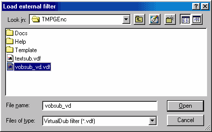

Step 1g) - Use the "Load external filter" to locate and open the "vobsub_vd.vdf" file.
Step 1h) - After you have loaded the VobSub filter, Click on it, and press the "OK" button
