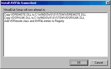

Pre-Steps - Before you
start with "VirtualDub", run
the "AuxSetup" and select "Install handler" and press "OK
" to confirm, when you are back at the "Auxiliary Setup" press
the "Run VirtualDub" button, and this will run the main program.

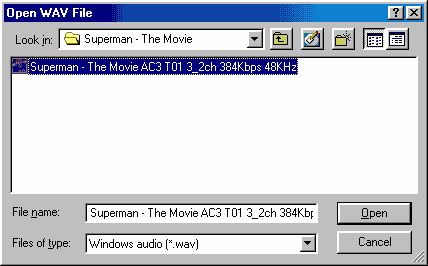

WAV files, only then you use this option! If not, skip to Step 2. Click
on the "Audio" menu and Instead of the default "AVI audio"
select "WAV Audio", this will cause a "Open WAV File"
window to popup, here you select the Audio Track created earlier using DVD2AVI, Click
on "Open", then under the "Audio" select the "Full processing mode" option.

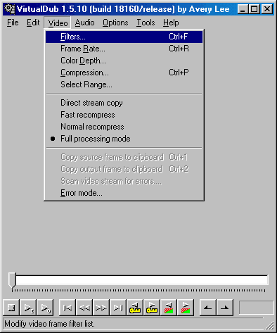

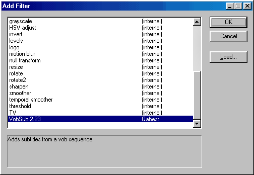

Step 1d - To add "Filters"
such as Subtitles, Click on "Video" and select "Filters"
if you want to add the VobSub filter.

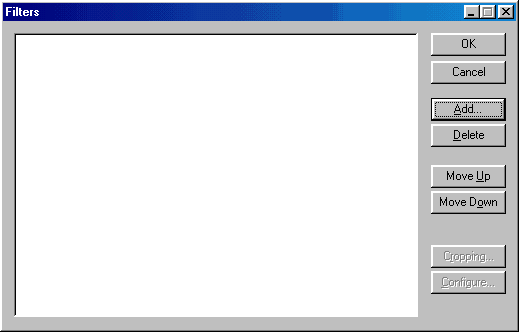

Step 1e) - In the Filters menu, click on the "Add..."
button.

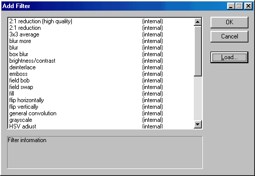

Step 1f) - In the "Add Filter" selection, if
your VobSub is not there, click on the "Load..." button.

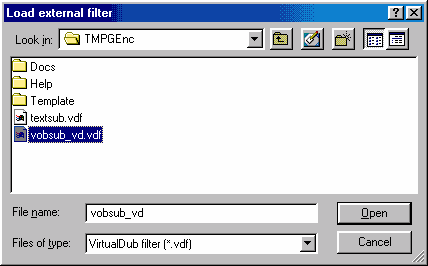

Step 1g) - Use the "Load external filter" to
locate and open the "vobsub_vd.vdf" file.
Step 1h) - After you have loaded the VobSub filter,
Click on it, and press the "OK" button

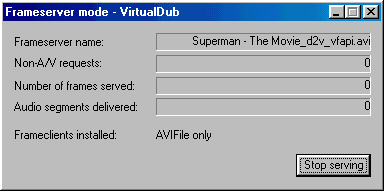

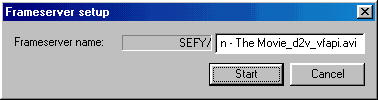

Step 2(a/b) - Click on the "File" menu and then
click on "Start frame server..." and when you get the "Frameserver
setup" click on "Start"
a) b)  |
Step 2(c/d) - After you clicked on the "Start"
button, you will be asked to save the new frameserved file, make sure
you add .VDR at the end of the file, as it is NOT being
added automaticly. This will make VirtualDub ready to serve, when you
are done with encoding, press on the "Stop serving" button.
