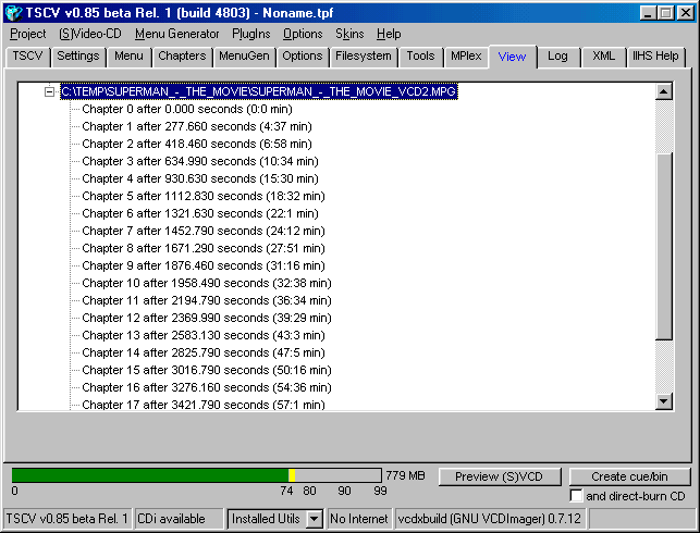

| Step 5 - In the "View" category you can check to see
when each of the chapter will come in the movie.

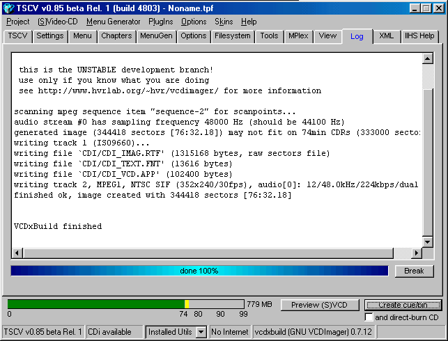

Step 6 - Go to the "Log" and press on the "Create
cue/bin" and this will create the files which will be burned
later on.

Step 9 - Go to the "View" to check if all the
chapters are to your satisfaction.
Step 10 - Go to the "Log" and press on the "Create
cue/bin" and this will create the files for the second part of
the movie.
