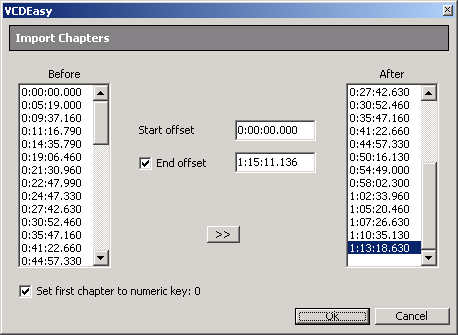

Step 3a - Press the "Chapters" menu item and Here you
can select to import the Chapters for your movie, Right Click
to get the popup menu so you can import from Smart Ripper or
Chapter-X-Tractor.
NOTE: Write
down the "Duration" time of the first half of your movie, you will need
it as a "Start Offset" for the second part. If your movie is only a
single file, then ignore this.
Step 3b - Select the "End offset " for the first part of
the movie, and press the ">>"
button, this will add all the chapters to the "After" table and then press the "Ok"
button when you are done.

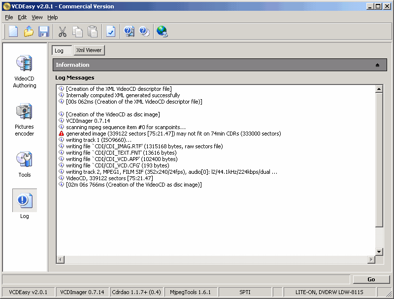

Step 4 - Press the "Go" button, VCDEasy will begin
analysing your MPG file and create an Image file for burning.

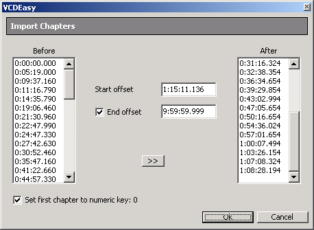

Step 5c - As in Step 3a and 3b, write in the "Start offset" the exact lenth of the
previous part, in this example it's "1:15:11.139"
and just mark the "End offset"
as the end of the movie, and press the ">>"
button, this will add all the chapters for the second part of the movie
in the correct Chapter Times on the "After"
table.
