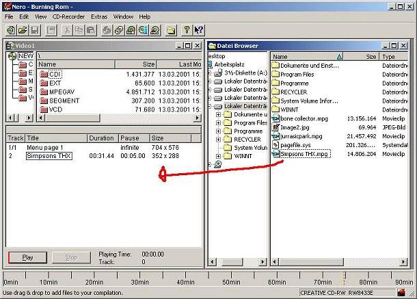

1. Locate your .mpg and drag it.(see picture below).
2. Check the time so it's fit on a CD, the time will not be the same as the videoclip.
3. Rename the CD to anything you like by clicking F2 on NEW.
4. Press right mouse button at the file that you added to the SVCD and select properties
5. Now change under menu the title of your movie. This title will be shown in the menu of your svcd.
6. Change the picture used as thumbnail if you selected thumbnails under the layout and press ok.
7. If you have added other movies the SVCD, then do the same with it.
8. Doubleclick on track 1/1 (Menu page 1) will show you the result of your menu.
