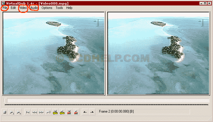

Launch Virtualdub/Nandub(extract all files
to folder and run the virtualdub.exe/nandub.exe)
Open the Videoclip that you want to convert, File->Open
video file
(If you are converting from a VCD, open the .dat
file in the MPEGAV folder.)
(If you are converting from a SVCD, open the .mpg in the MPEG2
folder. Be also sure to use Virtualdub-MPEG2)
Select under Video->Fast recompress (Do
not use full processing, read
here why)
Select also under Audio->Full processing (If
you are only going to reconvert the video choose Audio->Direct
Stream Copy and use Virtualdub
MP3 Freeze).
Select
Video->Compression
(see below here)
Select Audio->Compression (see below
here )
(Optional Select Video->Filters (see below
here ) - required step for SVCD or if you want to resize/crop
the video)
And last hit File->Save AVI.
Done.

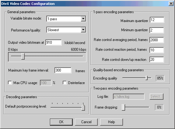

Video Compression
Select DivX Low Motion(DivX3.11) or DivX
Codec 4(DivX 4 or 5) and hit Configure. If you can't
find any DivX Codecs be sure to install it first, you find
DivX Codecs here. (Use DivX 4 for
best compatibility)
![](/images/virtualdubdivx2.png)
Here can you change the video bitrate, the
bitrate decides how many minutes you can fit on for example
a CDR.
Use a DivX bitrate calculator to
calculate the bitrate. Use default settings and Hit OK
